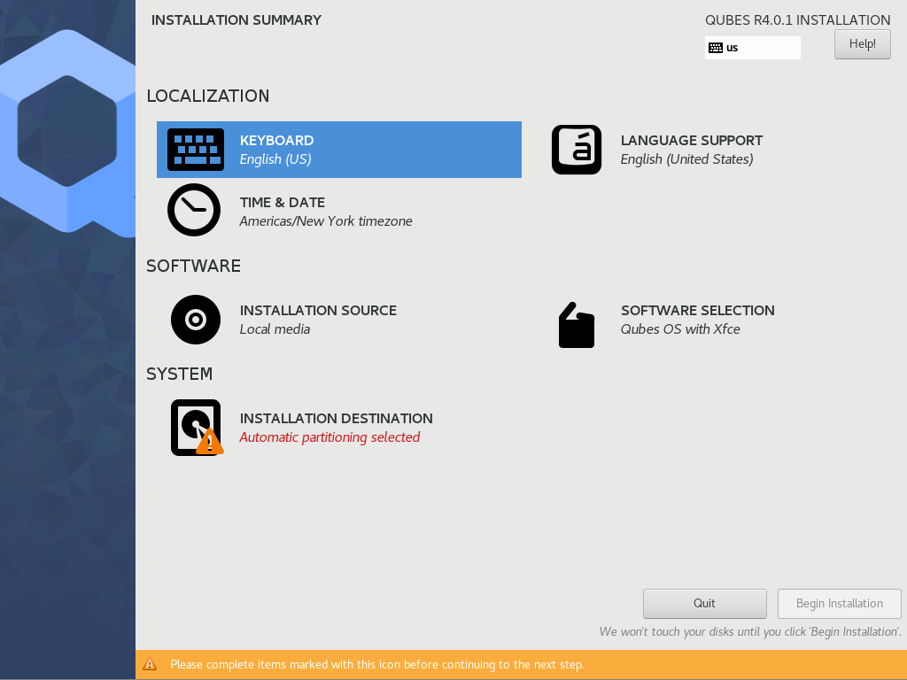

Installation summary
The Installation summary screen allows you to change how the system will be installed and configured, including localization settings. At minimum, you are required to select the storage device on which Qubes OS will be installed.
Installation summary not ready

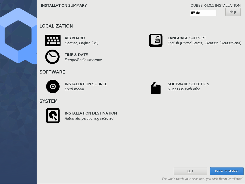

Localization
Let’s assume you wish to add a German keyboard layout. Go to Keyboard Layout, press the “Plus” symbol, search for “German” as indicated in the screenshot and press “Add”. If you want it be your default language, select the “German” entry in the list and press the arrow button. Click on “Done” in the upper left corner, and you’re ready to go!
Keyboard layout selection
The process to select a new language is similar to the process to select a new keyboard layout. Follow the same process in the “Language Support” entry.
Language support selection
You can have as many keyboard layout and languages as you want. Post-install, you will be able to switch between them and install others.
Don’t forget to select your time and date by clicking on the Time & Date entry.
Time and date

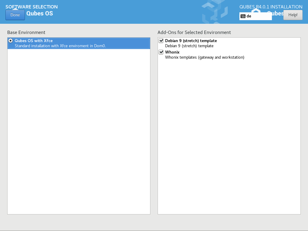

Software
Add-ons
On the software selection tab, you can choose which software to install in Qubes OS. Two options are available:
  • Debian: Select this option if you would like to use Debian qubes in addition to the default Fedora qubes.
  • Whonix: Select this option if you would like to use Whonix qubes. Whonix allows you to use Tor securely within Qubes.
Whonix lets you route some or all of your network traffic through Tor for greater privacy. Depending on your threat model, you may need to install Whonix templates right away.
Regardless of your choices on this screen, you will always be able to install these and other templates later. If you’re short on disk space, you may wish to deselect these options.
By default, Qubes OS comes preinstalled with the lightweight Xfce4 desktop environment. Other desktop environments will be available to you after the installation is completed, though they may not be officially supported (see advanced topics).
Press Done to go back to the installation summary screen.

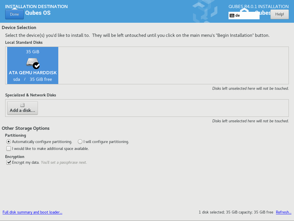

Installation destination
Under the System section, you must choose the installation destination. Select the storage device on which you would like to install Qubes OS.
Your installation destination can be an internal or external storage drive, such as an SSD, HDD, or USB drive. The installation destination must have a least 32 GiB of free space available.
Installing an operating system onto a USB drive can be a convenient way to try Qubes. However, USB drives are typically much slower than internal SSDs. We recommend a very fast USB 3.0 drive for decent performance. Please note that a minimum storage of 32 GiB is required. If you want to install Qubes OS onto a USB drive, just select the USB device as the target installation device. Bear in mind that the installation process is likely to take longer than it would on an internal storage device.
Select storage device
As soon as you press Done, the installer will ask you to enter a passphrase for disk encryption. The passphrase should be complex. Make sure that your keyboard layout reflects what keyboard you are actually using. When you’re finished, press Done.
Select storage passhprase

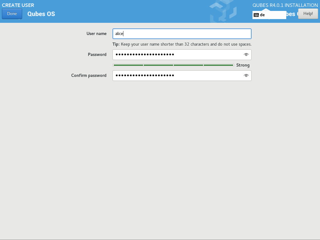

Create your user account
While the installation process is running, you can create your user account. This is what you’ll use to log in after disk decryption and when unlocking the screen locker. This is a purely local, offline account in dom0. By design, Qubes OS is a single-user operating system, so this is just for you.
Select User Creation to define a new user with administrator privileges and a password. Just as for the disk encryption, this password should be complex. The root account is deactivated and should remain as such.
Account name and password

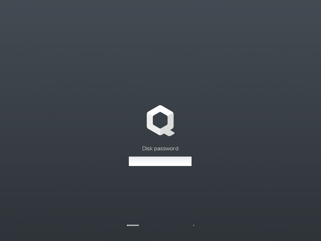

Just after this screen, you will be asked to enter your encryption passphrase.
Unlock storage device screen
