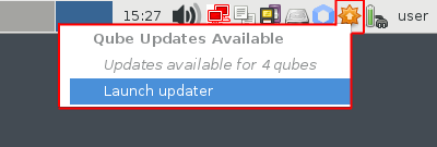

You can accomplish this using the Qubes Update tool. (Warning: This tool is currently affected by bug #6585. See below for a mitigation.)
By default, the Qubes Update tool will appear as an icon in the Notification Area when updates are available.
However, you can also start the tool manually by selecting it in the Applications Menu under “System Tools.” Even if no updates have been detected, you can use this tool to check for updates manually at any time by selecting “Enable updates for qubes without known available updates,” then selecting all desired items from the list and clicking “Next.”
