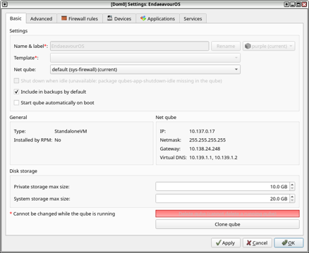

Image of Qube Settings
In this example, Network Manager on KDE, the network had the following values:
  1. IPv4 networking
  2. IP address 10.137.0.17
  3. Netmask - qube settings showed 255.255.255.255, but we decided to use 255.255.255.0
  4. Gateway 10.138.24.248
  5. Virtual DNS 10.139.1.1 and 10.139.1.2

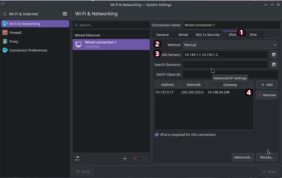

Image of Network Manager, annotated by numbers for reference below
The network was set up by entering Network Manager, selecting the Wi-Fi & Networking tab, clicking on the Wired Ethernet item, and selecting tab IPv4 (1). The Manual method was selected (2), which revealed areas for data entry. The DNS Servers section takes a comma-separated list, here 10.139.1.1,10.1.139.2 (3). At the bottom of the tab (4), the ‘+ Add’ button was selected, and the IP address of 10.137.0.17 entered in the ‘Address’ column, the Netmask of 255.255.255.0 entered in the ‘Netmask’ column, and the Gateway of 10.138.24.248 under ‘Gateway’. Selecting the “Apply” button stored these changes
